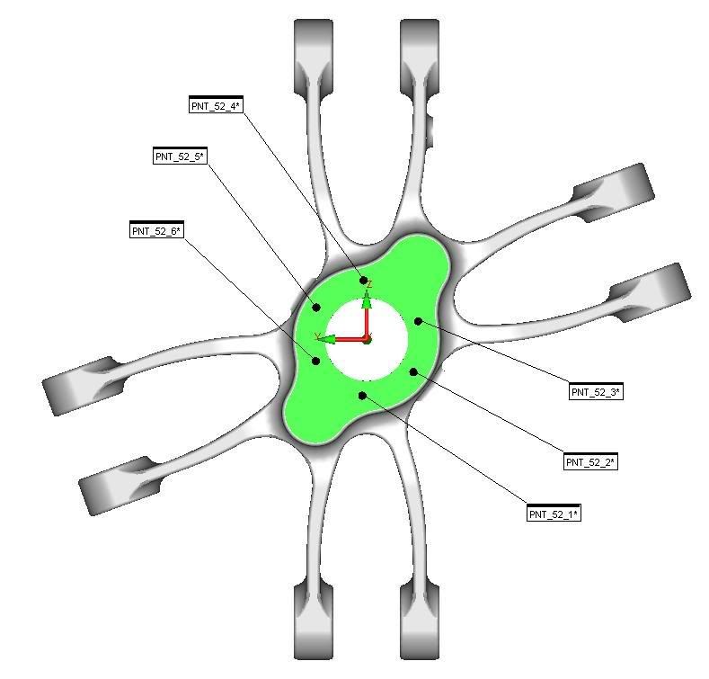

    I have been trying to format our output reports to generate a point map diagram of the out of tolerance items. The basic tact that I have taken is to generate a viewset of the points that make up the different feature sets.
    http://i20.photobucket.com/albums/b2...well/FS_52.jpg
    I have then constructed an If statement as:

    IF/PRF_52.OUTTOL <> 0.000
                RECALL
    /VIEWSET,FS_52
                DISPLAY
    /METAFILE""CAD
                FORMFEED
    END_IF
    The plan is to evaluate the dimension statement; recall the viewset if the dimension is out of tolerance; capture the viewset to the report; formfeed to the next item and repeat as needed. This would be really handy for our rework cycle as the Finishers would be able to see which point was out of tolerance and where the rework would need to take place.
    My problem is that the once I generate the DISPLAY/METAFILE, "", CAD in my IF statement, the graphic stays hardcoded into the report, even if the item is in tolerance.
    Where am I fouling up or is this one of the "charms" of PC-Dmis. BTW, I am doing this in 3.7 MR3.
            Thanks for any help you may be able to give.
            This works as coded, make sure you are looking at the View Last Execution Report Mode, and not the standard Report Mode view. The report mode view will never look at flow control commands.
            If you are looking at the right report screen, check Reset Global Settings When branching. Display/Metafile isnt listed as a global setting, but ya never know. Also, if all else fails stick a breakpoint in there and make sure the cursor is jumping over the display command.
            This works though, and a pretty cool idea at that. I can see a very sharp use of this in the 4.0+ rule trees with the new interactive analysis window.

              ahhhhh.... Last execution mode. I ALWAYS forget that. I'll give it a shot. Thank you!
